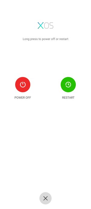

The steps for Safe Mode should be the same across all variants of that phone. You're saying you can't get Safe Mode to come up with those steps?
Ok, try the method here instead -- it's for the Note 30, but the XOS version looks more like yours.
On my brother's phone (Infinix hot 30 play), I was able to turn it on, in first try. But on my phone, I tried this 11 times but was unable to turn it on.
