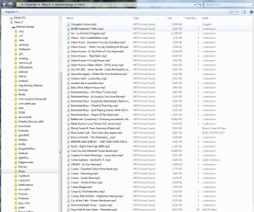

Not sure what your issue is but the attached screen shot shows what I see on my N7 Android 4.2.1 after I plug it in. You can see all the folders for each app, and I opened my \Music folder to show that the contents are all there (detail view).
So something is not right.

Thanks for the reply bigtroutz. Have no idea why I was seeing what I was seeing but after rebooting the N7 all was fine. I should have done that first thing.
