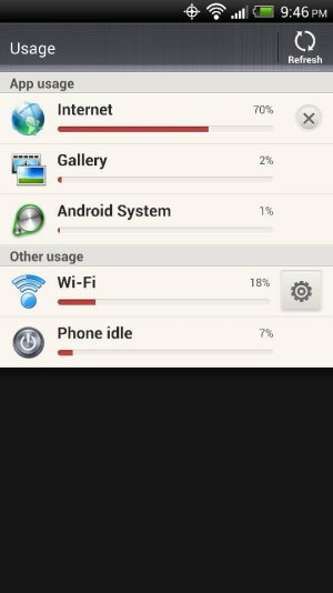

Internet is using 70-75% of battery after firmware update
rstripes72071#WN
May 14, 2010
52
Ever since the DNA firmware update, my battery barely lasts 24 hours without me even using it! When i check to see what is using the battery, it shows me that internet is using a whopping 70-75% of the battery. Is anyone else seeing this, and if so, have you found a solution? FYI, i haven't done a hard reset yet, just a soft one.

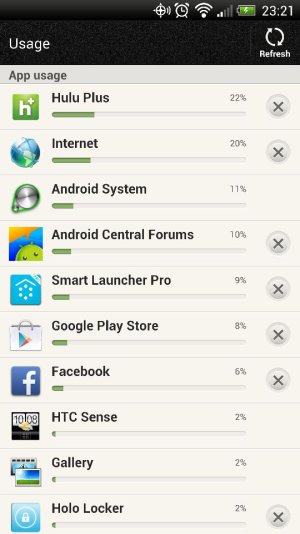

Not for me. Internet is normally always one of my top apps, but never over 20%
Sent from my Verizon Droid DNA

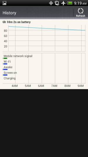

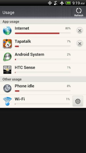

I performed a little experiment last night and fully charged my phone, restarted it, and put it into airplane mode overnight. Sure enough, the battery dropped to 80%. The culprit:
It looks like the browser is having some aberrant activity. I would do a factory reset today, but my laptop died yesterday and I'm away from my desktop.
That is so weird... Have you tried clearing the cache for internet? May not help, but it is worth a try before doing a factory reset.

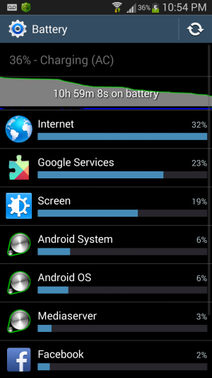

I think I solved the issue! I discovered it here. The problem is with sync in your google account. I just turned mine off completely but there's more detailed instructions on how to fix it. Go to Settings>Accounts>your Google account and turn off browser. Problem solved instantly!
