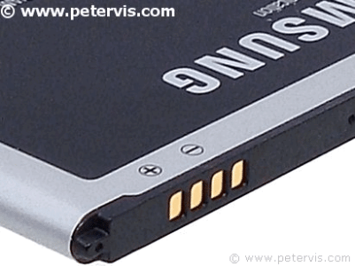

For those of you who are experiencing this issue, I found my solution. I was reading all these solutions, but i didn't want to get another phone or battery. So what I did was clean the contacts of the battery with a piece of cloth, making sure debris or any other particle wasn't on it. If you don't know what contacts are, they are the 4 gold strips on top of the battery. I also cleaned the pins that the contacts press against. Hope this helps you guys! :cool:
This is the contacts of a phone battery.
