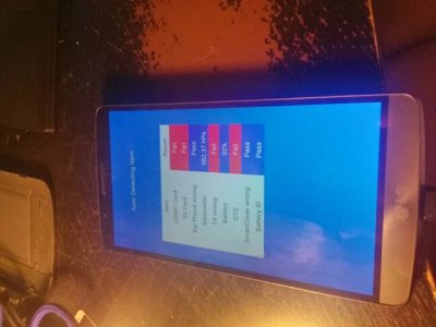

Update... Definitely was the phone. Using the hidden test menu I was able to check its ability to read my Sim. Note it didn't say it was invalid, it flat out could not read it.
