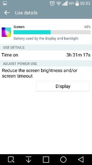

Normaly, with auto brightness on, SOT is around 5,5hours here.
This is my last night situation with 50% battery left:
