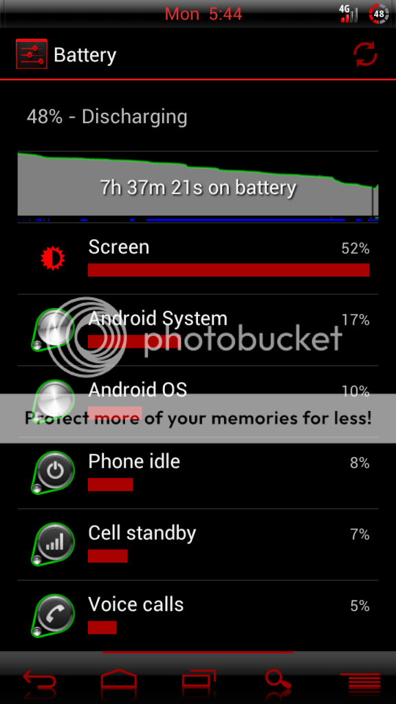

I just checked the battery screen and it shows 48% screen, 17% android OS and lol 10% facebook which is funny because I've only been on there a few times today. I wonder if it's running in the background. 6% is Maps which I haven't used at all today then 5% idel, 4% standby and then it drops to 2% items.

also, some screen shots of the battery stats would help us out :)

When you click on the battery graph, you can seen a few lines under it... one is screen on time, and awake time...
when the screen is on, the phone is obviously awake...
you cant help that...
but what contributes to bad battery life is how often it is awake when the screen is off
-Danny
Interesting thanks!
I don't really know how to read it but the awake is longer than the screen on.
I'll play the charge it then disconnect it tonight and post some screen shots.
