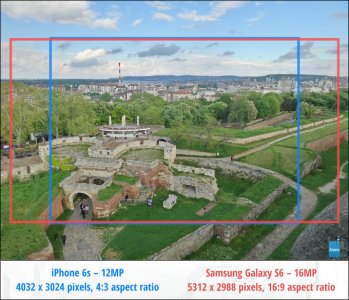

IIRC the Note 4 has a 16:9 aspect ratio sensor, where the Note 7 has a 4:3. So in reality you are not losing ANY resolution. Just chop of the 2MP on each side off the Note 4 sensor to get the 4:3 aspect ratio of the Note 7. Done.

they made a trade off of pixels to gain in other areas.
Yes, they made a trade off... to gain but it isn't as much as you think. The newer 12MP sensor actually has a higher vertical resolution than the sensor in the Note 4, it is just that it is a 4:3 sensor and not a 16:9 sensor... so the Note 4 has two 2MP bands on the sides of the frame. Once you account for the difference in focal length between the two sensors, the 12MP has ever so slightly higher resolving ability.
Here is a graphic that illustrates this very clearly (thanks to Phonearena.com)
(The iPhone has the same resolution and aspect ratio as the one on the S7 and Note7... and the S6 shares its sensor with the Note 4 and 5 for that matter)
Fact of the matter is that any difference in picture quality between the Note 4 and Note 7 will not be related in any appreciable way to the number of pixels either phone has because outside of the aspect ratio change, they are virually identical.
