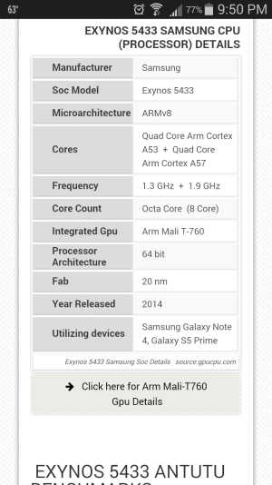

According to GSM Arena and Rootzwiki the exynos 5433 is 64 bit and made with ARM Cortex 57 and ARM Cortex 53 cores. According to ARM these are both 64 bit processors.

How come every single site says it's 64 bit I can't even find one that says it's 32 bit and you done nothing to prove it's 32 bit other than say it is? You got anything other than your opinion?

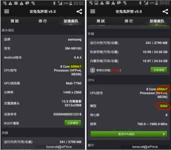

Just a follow up, was reading xda forum and one of the guys said something interesting..
Instruction set ARMv7 is in ARM Cortex A53 and ARM Cortex A57. I have been play with HTC Desire 510 64bit for a while in shop. Installed Antutu and it show ARMv7 in details.
ARMv7 is read from OS as Android 4.4 is 32bit.
IF Exynos 5433 is 64 bit, we will have more with Android L
So if we lucky the exnyos could be 64bit

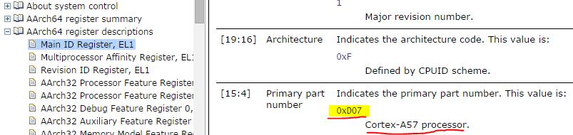

First of all apologies to "ace0187420", he was right about the 64-bit part. I did some new digging, and found conclusive evidence that it's a 64-bit A57-based SOC.
This is Exynos 5433 Geekbench result : http://browser.primatelabs.com/geekbench3/745794
Concentrate on variant 1 part 3335 revision 0
variant 1 revision 0 = r1p0.
part 3335 means it's part of A57 family. Check the proof below.
0xD07 is equivalent to 3335 in decimal, which is the number mentioned in Geekbench.
Also check it says "AArch32". This is another proof that it is A57-based. AArch32 is ARMv8 32-bit execution state and is meant for 64-bit SOC.
Why the hell Samsung named it Exynos 5xxx is beyond my imagination.
Note: We can also see new Exynos 7-series processor in works which also based on A57. No idea what happened to Exynos 6-series.
Few details here: https://www.mail-archive.com/linux-samsung-soc@vger.kernel.org/msg35957.html
