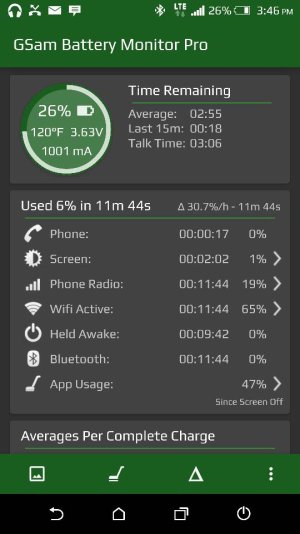

Actually I think heat may be the problem. I have never gotten past 45 degrees on the phone, normally not even past 40 since the update. Until I hit 49 celcius or 120 Fahrenheit because I was running GPS in my car and my phone wasn't even connected to a charger or it would have been hotter.
How do I check the phone temp? Somewhere in settings?
If this phone can't run GPS and charge it's going back. Still have my M8 right here...

Install GSAM. You will see the real time temperature in the top left.
Here was the screenshot with GPS running. To be fair I also was streaming music as well.
Good lord, 120 degrees!
