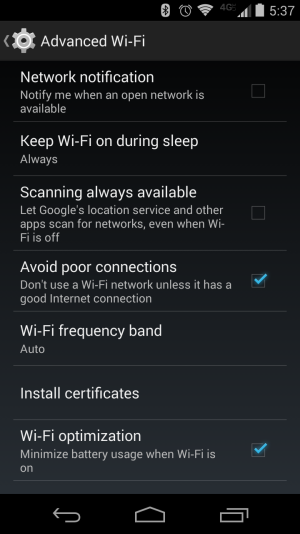

That is a stock Android menu for 4.4.2 so not sure why HTC Sense is missing it.
I think that is stock for the M8 4.4 not the M7.
