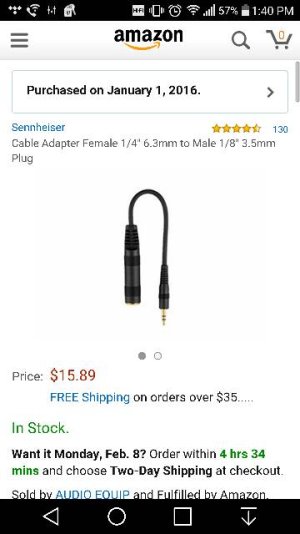

I have the same issue with my hd 700's. Every time I plug my headphones in I get that google prompt. My guess is the Jack is touching something inside the phone is causing this. This is my second v10 as my first one the headphone jack got messed up because I didn't buy the adapter for the 1/4 to 3.5mm and the weight of the jacks completely messed up the phone. I couldn't move a centimeter without that google prompt showing up. I still have this issue with my second v10 but it has drastically reduced the prompt now that I use this adapter.
