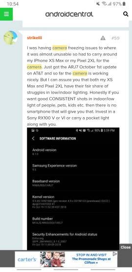

I had to dig around but found it
The update in October and November did help some people with camera freezes. So if your on December update I would try factory reset.
