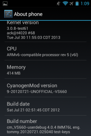

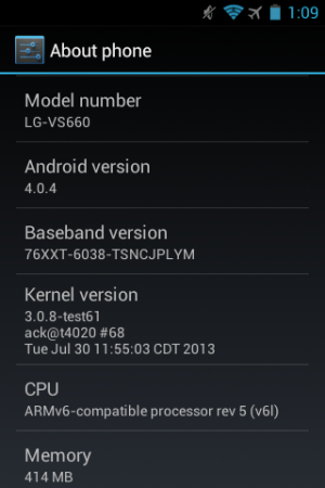

Here no so big choice of ROMs for VS660 at all. I started to test all similar ROMs for LG phones, ROM for Optimus One refused by phone)) so I begin to see for CDMA phones. Optimus V and S are similar in spec, so if use S, hard keys need to remap, V ROM better, but here 2 types, one do not work at all, second works +/- well.
So in fact I have LG Verizon VS660 with b6-cm-10.1-20130715-thekraven-LS670 ROM + Virgin.fix4.3.0kernel.jbc-CM10.1 + 3.0.8.test_60
this is most stable working, only 100% batt all time and accelerometer working +180 from real position.
in case if used 3.0.8.test_55 - can work 1-2 hours, 10 hours after just switch off, need to remove batt and put back
3.0.8.test_50 testing now
main problem, if phone connected to charger or to PC and to reload it, it freezing at booting(((( need to re-instal kernel than and all ok)))
Re: [Kernel][ALPHA][android_kernel_lge_msm7x27-3.0.x (3.0.8)]
there's still issues getting the charger data right in the source code. the 3.0.8 stock msm_battery.c doesn't read most of the battery data, and doesn't read charger data right until after boot is finished. So it is still freezing up boot on some ROMS because the offline charging is locking up trying to read the charger info. You can remove /sbin/chargerlogo from the ramdisk to stop it or disable it in init.thunderc.rc in the ramdisk as well to allow booting until I get the battery fixed. I can maybe figure out what the difference between test 40 and on up is, because those pre-accelerometer versions boot ok with the offline charging enabled (they just don't see the charger at all.) I pulled that test 60 build because of the 100% battery issue. trying to get an alternate up soon.
the inverted accelerometer could be worked out in the driver itself. I just need hardware to test on, because of all the boot/check/rebuild cycles needed to figure out glitches.
that's very strange, as on 4.0.4 + your kernel 45-55 accelerometer working perfectly. but wifi disabl by this new kernel.
with 4.2 wifi working well, but accelerometer inverted, and this specially can see on photo, in any position it rotate +180 from current. so up became down)))
compare the /thunderc.init.rc files for wifi differences between 4.0.4 and 4.2. match the 4.2 settings into the 4.0.4 file and maybe your wifi will inititialize correctly.
test 61
'fixes' battery readout from test 60. bounces around like a jumping bean, though. manual calculation, probably slows down the kernel too. need to retrieve the value from battery rpc like before, no more time this afternoon though.
compare, size differences first of all and what in it
so working composition is next step by step: quattrimus-VS660-cm9-beta2 + 3.0.8.test_61.zip + init.thunderc.rc.cai.zip + OS-keyswap.zip
WIFI +
GPS +
Accelerometer + ( all working perfectly)
Camera and SD card + ( disappeared bug with SD, this only with happens using init.thunderc.rc.pac.zip)
and In fact it is VS660, 4.0.4, kernel 3.0.8.test_61
BUGS
cannot install GAPPS
if for ICS 4.0 - home button correct, but Google play closed in time of loadings after authorization
if for 4.2 - home hard key works like PG UP button... Google same story..
and known BUG indicated in 1st post
init.thunderc.rc.cai.zip for CAI to stop bootloop. no adb in CAI with this... in fact, no usb functionality at all. no charging indicator
night is long... try to see the turn for installing...
* note if I am installing GAPPS before kernel, apps no want to work, if after, same((( ** if use Virgin.fix4.3.0kernel.jbc-CM10.1 - hard key +, but WIFI -
If no installing GAPPS, manually install from SD all I need, all works perfectly for me:p:p:p:p
EDIT:
F**K that was amazing
so step by step
1. WIPE ALL + DALVIK + SYSTEM
2.quattrimus-VS660-cm9-beta2
3. gapps ics
4. kernel 61
5. init cai
6. os-kayswap
7. reboot
working WiFi, Accelerometer all rotations as need, Bt, GPS, root explorer ( put in apps), Navitel, Kate Mobile, Hard Keys as need.
installed new Google Play Store 4,2,9 working 2-3 sec after - Unfortunately. Google Play Store has stopped. If clear apps data, start, again accept conditions, it show 3 apdates for my apps, and 3-5 sec - stopped
so all apps need to discover in the internet and install from SD\PC (((
same no charge indicator and usb((
continue to testing)))
// LAST EDIT
no want to talk a lot
done next way
1. Wipe
2. ROM CM9
3. Kernel 061
4. Keyswap
5. Init ( took original 4.0.4 init.thunderc.rc, deleted boot logo line, replaced all wifi lines from init.thunderc.rc.cai)
6. flash gapps-ics-20120429-small
7. Reboot
Well, all working well +/-. no usb, no hardkey light, no battery indications
maybe can find some solution soon)))
wifi, accelerometr, finally works Play Stoere, Google play services, Gmail, etc ( all Google)
Installed apps
Facebook + Messenger
Foursquare
Skype
Kate Mobile
Navitel navigation full
Smart Keyboard Pro
MXplayer +codec
Unnistaller for root
Many thanks to bigsupersquid
