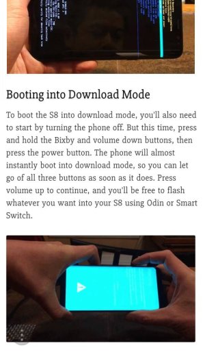

Just in case it's helpful...
Factory reset is your next step. In the same menu as wipe cache.
If that also fails you're looking at an Odin flash of either nougat or Oreo.
