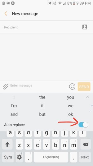

Figured out the auto replace problem. It actually has to be turned on in 2 different places. In the keyboard settings like everyone is probably used to and also on the keyboard when it is on screen by pressing the arrow at the top right. My option to not block offensive words works fine though.

The problem with the auto-replace where it stops working when using the Samsung Keyboard [on the Note 7] has an easy fix.
When using the Samsung Keyboard, touch the gear icon next to the Sym key (or hold press that key until the gear key shows, then touch the gear). This takes you to the Samsung Keyboard settings screen. Touch the Predictive Text option. Next touch the Auto Replace option. Finally, touch English (US). Then make sure all the toggles are turned on, all the way back on each of those settings. That's it. Problem fixed. The problem is that the language selection gets reset to blank, which breaks the whole auto-replace system.
...but you will find out that even after fixing the problem, it comes back every few days. I don't know yet what causes the language setting to clear, but that would be a great question for the Samsung engineers.
I hope this helps...
