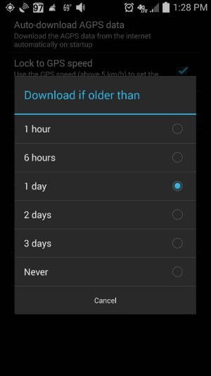

Question: Can the pro version be set to download the Ephemeris data automatically every few days?
These are your options for that data I think....uploadfromtaptalk1398533392840.jpg

What seems to speed it up a bit, is the app I downloaded (see above - GPS Status and Toolbox). It downloads the Ephemeris data and provides it to all applications requesting use of the GPS. I have it set to 6 hours and older.

2. Download GPS status. In Settings >> GPS & Sensors >> Auto-download AGPS data >> Choose: One hour.
