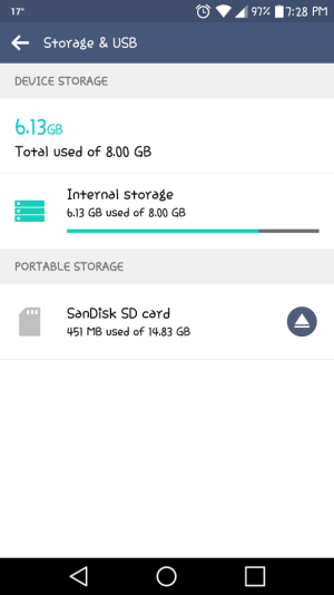

Hello... I have a Boost Mobile LG G Stylo that is currently running Marshmallow. It has a 16GB Sandisk MicroSd card in it. It has been formatted. I am running low on internal memory, so I started moving all movable apps to the sd card. After moving several apps, I am getting "Not enough Storage Space," When the sd card has about 10GB left of available space. I'm getting very irritated! Someone please help!

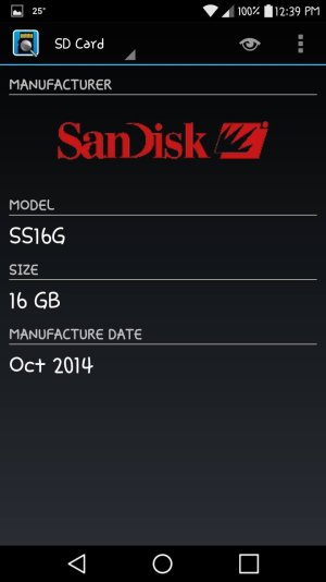

It's possible the card is counterfeit, and is actually of smaller capacity than what it reports. Run SD Insight to check its validity.
You're probably right, but just to be sure--where did you get the 2nd card from? If they're from anywhere besides a reliable bricks and mortar store, I'd still run SD Insight (it's a free app).
The counterfeits can't be told from real SanDisk cards by looking at the packaging - they're counterfeiting that perfectly. As B. Diddy said, SD Insight will tell you what's in the card. (If the date in some time in 1970, it's counterfeit - 0 is Unix date 1/1/70, and some counterfeiters neglect to put in a reasonable date when they reprogram the card. [There's a whole little computer in that card - controller, firmware and the storage area you use. It can be programmed to say it's any size, so you may have a 512MB card that claims to be 16GB.)
If SDInsight says it's a good card, contact SanDisk at SanDisk microSD Tech Support (there's live chat at the upper right). Even if the problem is your phone, they'll try to find out what's wrong. They're a great company to work with (which is why I always pay the extra it costs to buy their cards - the service is worth it).

I'm having the same problem. I just looked up on youtube and unfortunately LG blocked the use of internal storage for micro sd card and unfortunately Marshmallow doesn't let us move apps to sd card.:mad::mad::mad:
It let me move about ten apps to the SD card before telling me there's not enough storage space on the card, even though there is plenty.

I just recently bought the LG G Stylo for Boost mobile myself. Thanks to the morons at LG taking the choice of making the SD card a part of the phone; moving apps is the only way to alleviate space from the internal storage. I bought a 16GB UHS-I SanDisk SD card from Walmart and I have run into this same problem. My phone says there is "not enough space" when i have over 13GB of space left on the card! There has to be a flaw in the OS somewhere.

You're stuck with MM on that phone. It can't be reflashed back to Lollipop anymore. As far as the using the SD card, there is a fix for that which allows for the adoptable storage mode to work. Get a more knowledgeable friend to do this for you if needed:
6.0 LG G Stylo Boost/Sprint/Virgin Adoptable… | LG G Stylo

Thanks for this. Even though it limits the usability of the SD Card, it definitely remedies the problem with the internal storage.
