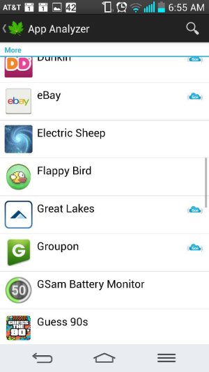

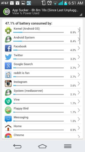

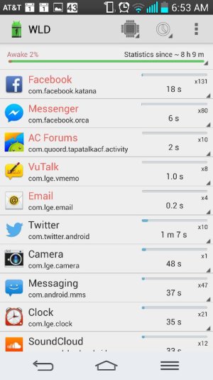

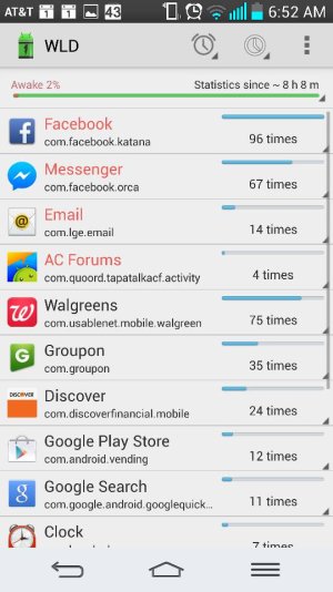

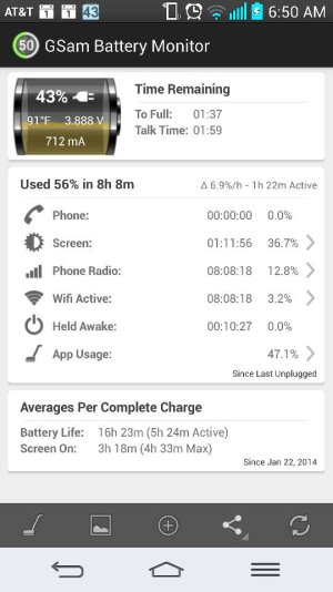

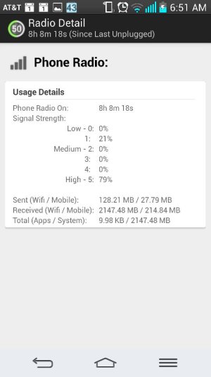

I've been reading up on the G2 and some reasons for battery drain. when I first got the phone, I could go 2-3 days without charge. now it will drop like ~10% an hour while at work. overnight (about a seven hour period) it dropped ~30%. I've posted some screen shots of my gsam, wld, and battery manager. 18% in 3 hours of doing nothing? I live in metropolitan Philadelphia, so my service area is 4glte, and I rarely have a service issue. sometimes I hace poor reception at work, but I work on floor 3 of a 20 floor high rise with drop ceilings..
based on the work, I said its gotta be Facebook. my messenger app is already greenified. I went into greenify to zap it, and it isn't listed!
I love this phone but I had the expectation that I could at least leave it unplugged at night and not suffer battery drain like this. any help would be greatly appreciated! sorry for the flood of pictures, just wanted to give an idea of what's going on in this crazy phone..

I read on another thread that rebooting after a 100% charge seemed to help. I did that, and I'm down to 93% in 2 hours. I uninstalled Facebook as much as I could (it's stock on the phone), maybe sent/received 30 texts and deleted some emails. The most damage is being done by the screen, which is using 27% of the battery.
If you're on 4G, 7% in 2 hours isn't bad depending on the signal in your area.
