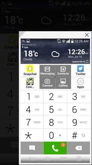

This is not really a fix but more of a workaround. On the cloudyG2 rom, there is a "mini-view" setting which resizes the screen to only use a specific area. I feel I will be using this until I could afford to buy a replacement. Screenshot_2015-06-15-00-26-11.jpg
