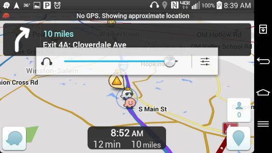

At least yours works on the stock version of maps. Mine doesn't work reliably on any maps versions, including Google maps, Waze, and VZ Navigator. I've had 6 different G2s with this issue, and I have sent this one to LG's repair center 3 times.
It will tell me to make a U-turn while driving 75 mph down the interstate! I don't know what to do. I even tried to fix the antenna as suggested on xda forums. It still doesn't work. Something seems to be improperly shielded inside the phone. My reliable old SGS3 locks instantly, and never screws up while I'm driving...but if I put it too near my LG G2, it completely loses its GPS lock. Does anyone have suggestions on how to fix the GPS on the G2 to not bork its own satellite locks?
