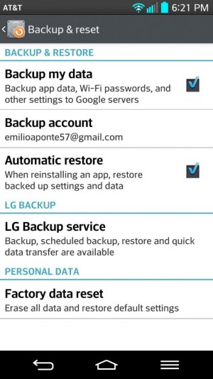

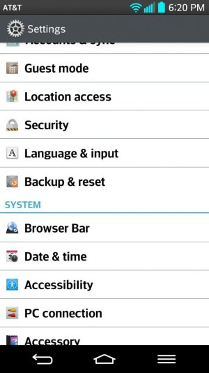

If you're running stock G2, not rooted go to settings, Backup and reset ? check out the screen shot ? Factory data reset ? check out the screen shot ?. If the full phone reset not fixes the problem, go to the store and change it for a new one. uploadfromtaptalk1388960889558.jpguploadfromtaptalk1388960919220.jpg
