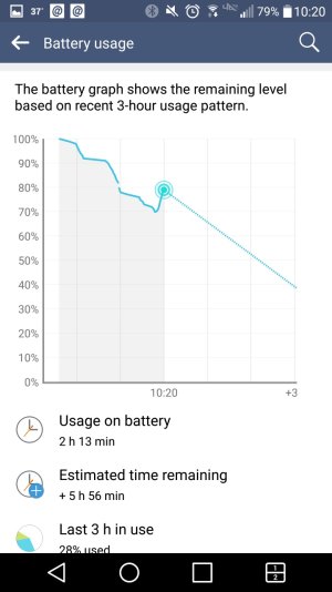

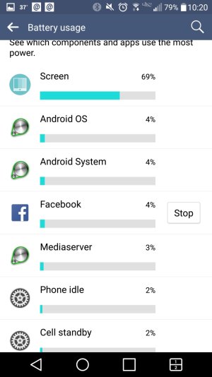

I had awesome battery life until I updated and got Marshmallow. Now my screen is eating the battery rapidlyScreenshot_2016-02-29-10-20-14.jpgScreenshot_2016-02-29-10-20-19.jpg.
