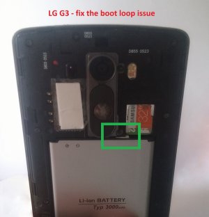

You guys need a new battery. The connector of the minus pole (=negative) doesn't connect well anymore causing the power controller board in the battery to demand more power. This will heat up the battery, CPU and power and volume buttons.
Because of the bad contact point the phone will also reboot as is the case for @aikanae:.
To fix the contact, you can solder it or just add something to press it together like in this picture.
Main topic: http://forums.androidcentral.com/lg...oot-loop-how-can-i-get-out-2.html#post5177159
