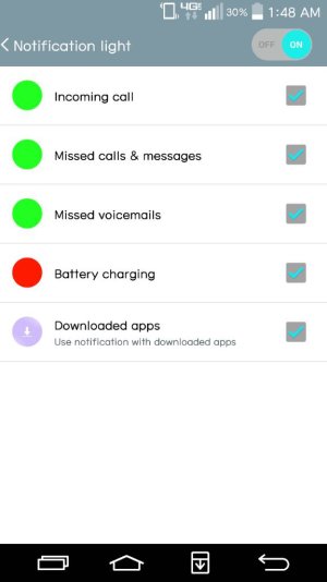

Is downloaded apps checked under settings-display-notification light?
Yep they are. The issue is not with the notificationd led. Its with the lack of push notifications. For example if simeone tags me or likes one post nothing shows up
