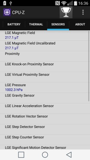

After many failed attempts of
-soft reboot
-safe mode
-hard reset
-dropping onto a carpet
I finally downloaded cpu z, noticed my sensors would react slightly to my rotations then immediately reset to 0. the sensors were stuck but dropping it onto a carpet was going too easy on my sensors. after a few hard knocks with my knuckles on the back of the phone near the camera the phone quickly rotated back and everything was working great!
