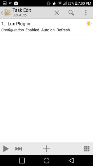

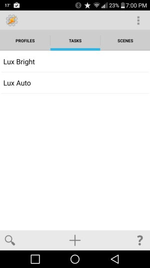

1) You'll need two Tasker tasks, one for turning up the brightness, and another one for re-enabling the Lux auto mode
2) When you add the Task, look under "plugins" for Lux.

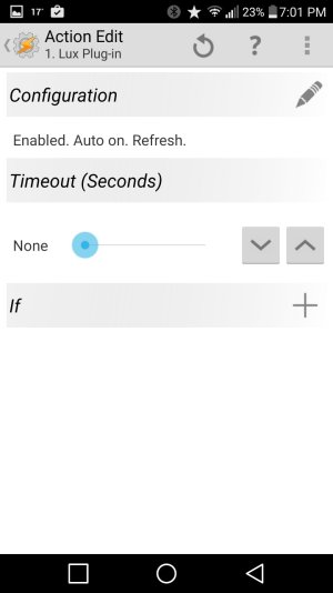

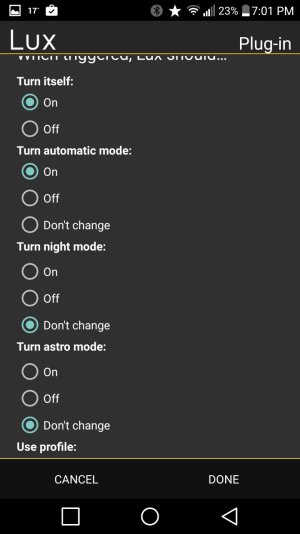

3) The task for re-enabling the Lux auto mode is easy. Click the configuration icon, and...
4) Set "Turn automatic mode:" to "On". Also, although it's not shown in the screenshot, I also check "Force: Refresh backlight brightness?" so that the phone goes back to a nice level right away after the app is closed.

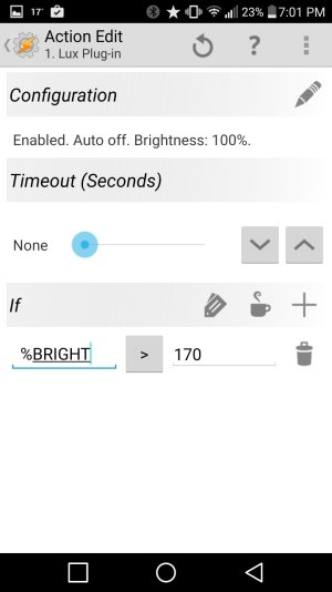

5) The task for setting brightness is more difficult. I decided I wanted it to go to 100% if the display was currently at 67% or more, and only adjust to 66% if the display was currently at less than 67%.
6) Set the "%BRIGHT" If statement to be > 170. Huh? Well display brightness, outside of Lux, is measured 0 to 255, so 170 is 2/3 brightness. We want to have Lux up the brightness to 100% if the display brightness is at 2/3 or more (greater than 170.)
7) Two steps to adjust the brightness; first turn off automatic mode.

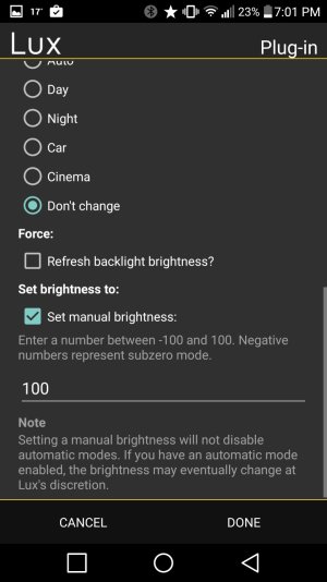

8) And then set the manual brightness to 100.
9) If the display is less than 171 (out of 255), I have another Lux adjust to just 66% brightness. (The screenshot shows this being done at "less than 170", but I've changed it since to "less than 171".)
