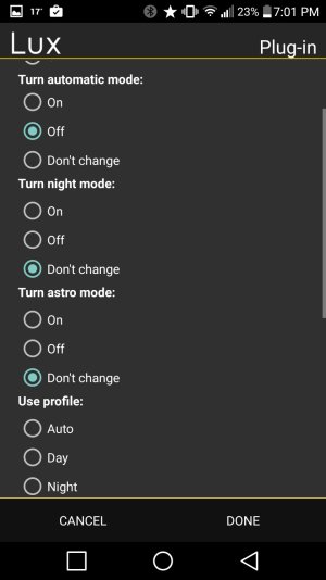

2) When you add the Task, look under "plugins" for Lux.
3) The task for re-enabling the Lux auto mode is easy. Click the configuration icon, and...
4) Set "Turn automatic mode:" to "On". Also, although it's not shown in the screenshot, I also check "Force: Refresh backlight brightness?" so that the phone goes back to a nice level right away after the app is closed.

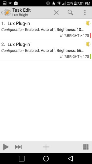

5) The task for setting brightness is more difficult. I decided I wanted it to go to 100% if the display was currently at 67% or more, and only adjust to 66% if the display was currently at less than 67%.
6) Set the "%BRIGHT" If statement to be > 170. Huh? Well display brightness, outside of Lux, is measured 0 to 255, so 170 is 2/3 brightness. We want to have Lux up the brightness to 100% if the display brightness is at 2/3 or more (greater than 170.)
7) Two steps to adjust the brightness; first turn off automatic mode.
8) And then set the manual brightness to 100.

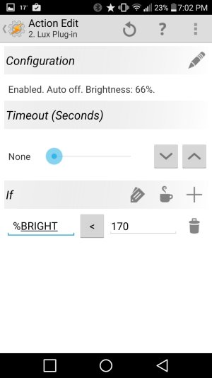

9) If the display is less than 171 (out of 255), I have another Lux adjust to just 66% brightness. (The screenshot shows this being done at "less than 170", but I've changed it since to "less than 171".)

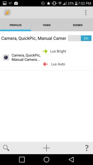

10) The final step is to attach the two tasks as Entry and Exit tasks for a set of applications. After you make changes to your profile, turn it off and on again to make sure it's in place.
