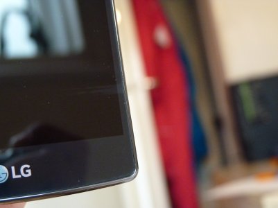

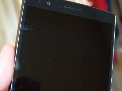

I've had my LG G4 for only 6 days and today after wiping off some fingerprint smudges I noticed some marks on the screen. The marks are on the lower right and upper left of my screen as seen in the pictures below. I've heard that others have noticed these marks too in exactly the same places on their screens.
Upon running my fingernail over the mark I can confirm I can feel a difference in the surface compared to the non-marked areas. It appears that the screen may have been damaged during the manufacturing process, perhaps on a production line or conveyor belt mechanism as the marks on other peoples phones are in the exact same place... some are worse than my marks and extend across the entire screen.
Please check your screens and post here if you have the same marks.

There's nothing to clean with alcohol... these marks are embedded into the material that makes the screen... they're not some kind of gunk stuck to the screen.
It's as though the screens or the phones have slid down some rails or have been resting on some rails at some point during manufacture. The screen appeared to be pristine when I removed the protective plastic and it wasn't until today when I was wiping the screen with a spectacles cleaning cloth that the marks appeared. As though some kind of protective oily coating had been applied at the factory (like when you polish your car paintwork, some scratches disappear, even though they're still there you can't see them because the polish/wax has filled in the scratches) and now I've cleaned (non abrasively I might add) the screen, any oils or chemical coating has come off

I'm so glad I found this thread because I have the same marks on my screen in the exact same place.. my bottom mark might b worse though. I also noticed the marks while I was polishing the screen with a proper cloth.
I'm going to be contacting Vodafone in the morning and will post a pic of my phone with my name in the picture so we can gather evidence because I agree there must be a number of handsets with the Same problem. Maybe one bad machine.

I had exactly the same issue with my device, so I went back to the T-Mobile shop and I got a new one right now, got the new one since two days ago, nothing on the screen for so far, hope this won't happen again, otherwise I will become real mad.
I had the phone for 7 days before and I noticed the same things on my screen on exactly the same spots, first right under on the screen and two days later I did notice two more, more up on the screen, on the exact same spot as I can see on your screenshots.

i just noticed some on my screen.
it's been over 14 days so i can't get a replacement with t-mobile. any suggestions?
They gave me a new phone last Monday and now I can see this stuff on my screen again.
