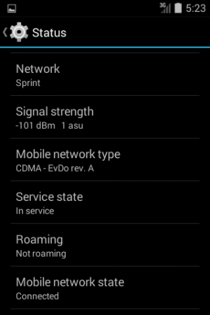

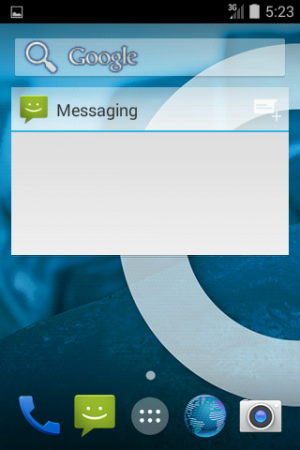

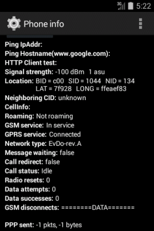

Look like someone donated you a phone? or are those tester screenshots?
by the way, your 'android' repo has a space missing before "revision" on line (83?) if I remember right.
View attachment 99448View attachment 99449View attachment 99450
I got data working. i'll push my changes tomorrow. Somewhere the androidarmv6 commits broke camcorder. I'll have to see what changes they made.

More like borrowed. Haha. The no data thing was bugging me. I think the fix was the jbc 10.1 overlays and inits. There's build.prop lines to test. Try switching on different ro.telephony.ril.v3 lines
Also thanks to skinbark for pointing to the team hydra github. I used their frameworks opt telephony . so I'm not sure if it works with the cm fork
