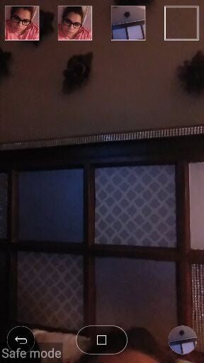

So i went into safe mode and opened up phone camera. Got the same thing.
Here's a screen shot of what happens. Disregard my lazy sunday football look. Lol

There is an Interval Shot feature which takes 4 photos at 3 second intervals: Interval Shot - LG Stylo 2 User Guide. Considering that your screenshot shows 4 small frames, it seems like the camera is glitching and trying to take Interval Shots, even though you're only tapping it briefly.
You're tapping the screen button, and not the Volume button, right?

Yea the screen button. Maybe I'll hard reset and see
