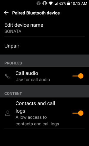

Notice how it only shows the phone symbol, not the headphones which I assume is media. Can't figure it out
Mine did this once but I restarted the phone during the same trip and it went back to normal. Hasn't done it since.
Your screenshot only shows Call audio. On my Bluetooth profile for my car there is an entry right below that one for Media audio. When you try to re-pair your V20 with your car make sure you delete the V20 Bluetooth profile from your car AND your phone to make sure you get a "fresh start."
