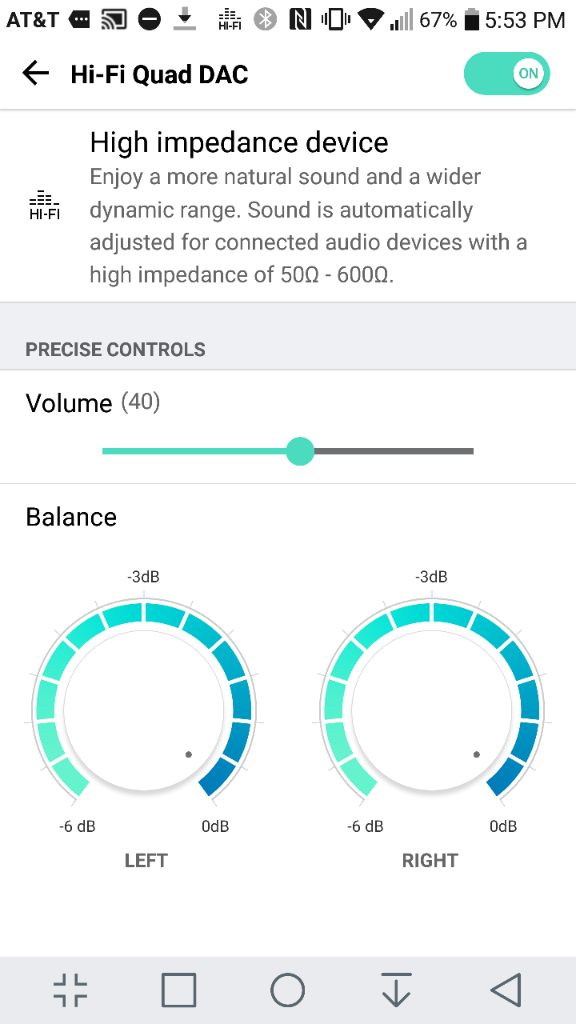

Let's face it. The primary reason that people are going to buy this phone is because it has the equivalent of a $300 external DAC/Amp built into it. LG has done advertising for months touting the ES9218 "Quad" DAC that they included. The only problem is that they include NO WAY TO USE IT!! The phones API only exposes the ES9218 DAC as a PCM 48Khz capable device. That means that the built in Qualcomm DAC that is worth about thirty cents is about as good. Here is proof from the developer of NeutronMP...
According your logs (Thank you for making them!) OS declares only one
(!!!) frequency - 48000 kHz. You can see it in logs:
[13:08:16] I <SFX>| enum: device 0
[13:08:16] I <SFX>| enum: id = 1
[13:08:16] I <SFX>| enum: type = 1
[13:08:16] I <SFX>| enum: name = LG-LS997
[13:08:16] I <SFX>| enum: is sink = 1
[13:08:16] I <SFX>| enum: is source = 0
[13:08:16] I <SFX>| enum: channels [1]:
[13:08:16] I <SFX>| - 1
[13:08:16] I <SFX>| enum: sample rates [1]:
[13:08:16] I <SFX>| - 48000
[13:08:16] I <SFX>| enum: sample types [1]:
[13:08:16] I <SFX>| - 2
It means firmware does not expose Hi-Fi DAC via this new API. Why LG can not make it and expose DAC and solve the problem with using full potential of the device - puzzle. Neutron would use it automatically if DAC is exposed by the firmware.
I have contacted both LG and Sprint and neither support staff is willing to escalate. We need to demand action as a group as this is the PRIMARY unique feature of this particular smartphone.
