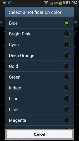

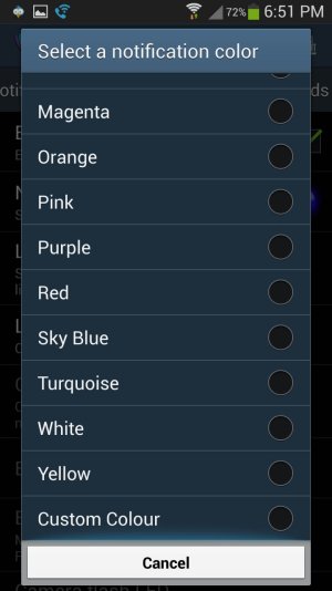

Thanks for the reply. I'm not sure what you mean. Under NOTIFICATION COLOR in the LIGHT tab I have chosen blue, for example. In the same tab, for LED FLASH RATE, i have VERY FAST chosen. These are the exact same settings I used on my S3 and all worked. With the S4 changing the flash rate doesn't seem to affect the actual rate of flash. Not a deal breaker and I'm happy that it works, but I would like to see if I can correct that.
Thanks again.

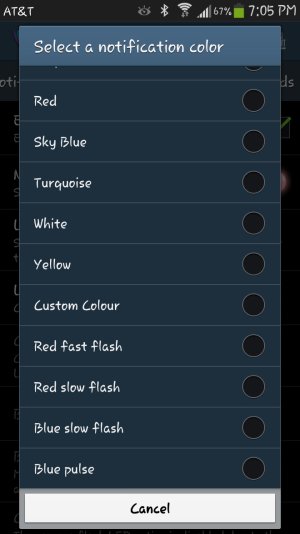

As your notification color did you pick a normal color or one of the flash/pulse ones? It seems if you pick, for example, "Blue slow flash", you're going to get a slow flash no matter what setting you choose in "LED flash rate". If you choose just "blue" though, you can then change the flash rate in the "LED flash rate" setting.
Thanks again.
If you scroll down through the LED colors available, there are some like "Blue slow flash" at the bottom. I'm not really sure why those are there - maybe Andrew can explain.
Last night I was changing a flash rate and trying to figure out which one was best and it was definitely working - using the test mode icon in the top right. I'm not sure why yours isn't working properly but I cycled through all available flash rate options and each one was different as expected. As I said above, I could not get them to work correctly when I had chosen "Blue slow flash" as my COLOR...I then changed it to just "Blue" and it worked...but that doesn't seem to be your issue.

I'm sorry but I'm a bit more confused. I just double and triple checked through the LED colors available and there are no options other than just standard color names. I took a picture of my screen, both top and bottom of the color list.
Not sure why I have these and you don't - hoping Andrew pops in and clears some things up. Are you on the latest 3.7.1? See attached.

I just checked and I am on 3.7.1. That is very interesting. I guess I'll keep an eye on this thread and see if Andrew can shed some light. Thanks for the screen shot... never saw that before.
