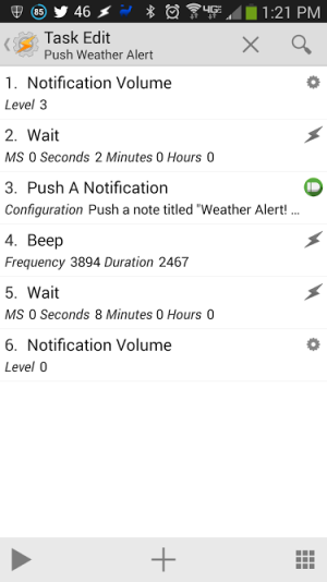

I figured it out with Tasker. If it was beween 22:30 and 7:00 and a notification popped up with "*watch*' "*warning*" or "*alert*", I ran this:

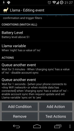

this is what mine looks like :
I have two others for different battery levels and as you can see I use Llama variables. In advanced, I checked the repeat box and set it to 15 minutes for this event...
For your event, you just have to add the leave area and wifi disconnected conditions.
Add a queued event [with data not connected condition (optional)] and set these actions : turn data and sync on.
Add another queued event that fires after 1 minute with these actions : turn data and sync off.
enjoy ;)
