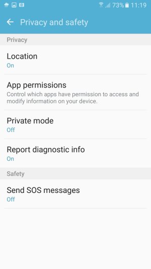

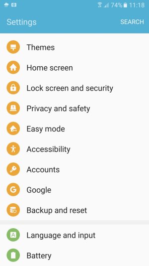

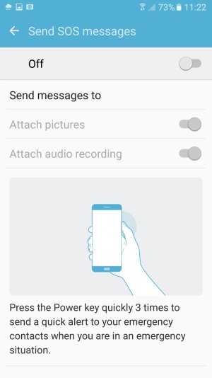

In settings
and the SOS settings
A full description of the SOS function is available in the online user guide on the phone
Bosbouer
Oct 9, 2012
1,175
Visit site
My s6 is an international unlocked version. Could be carrier related. Do you see no "emergency calling" or SOS facility in the settings?
