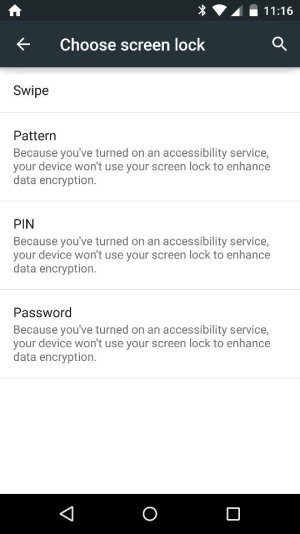

I wish... My options are only: Swipe, Pattern, Pin, Password.
"None" is not an option anymore. Was in my Note 3 running KitKat. Are you on Lollipop and have the "None" option?
This is what my setting page looks like. Can't scroll up any further.
WTF lol. I just went to the support page and it also says it should have NONE as an option.
Wonder if I did something to eliminate it. Some kind of app I installed. I dunno. If I have to do a factory reset I'm gonna lose my mind...

I went ahead and did the factory reset. I got my "NONE" lock screen option back so that's exciting. I checked the security settings after every three apps I installed to try to find the culprit but it wasn't any of my apps that did it.
I had a pin lock for a day... Wonder if just adding a pin lock, even temporarily, caused it. Maybe just a bug. I didn't have any special security programs or apps installed.

You likely had a Guest account active, you needed to open that and sign out for the None option to reappear.
Wow, now that you mention it, I was testing out the guest account feature. Good to know for future reference, thanks. The factory reset wasn't as painful as I thought it would be. Almost felt like I was unboxing again lol. I stress "almost"
