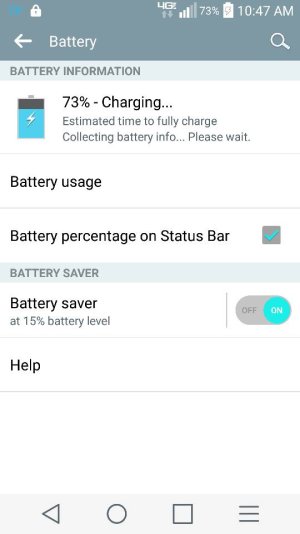

So after I did the update I did a factory dats reset. Everything worked fine for a couple days. Now this morning I am plugged into a 2A Belkin charger and LOOSING charge. This charger worked flawlessly before the update. WTH?
So I checked my battery dats just now. Can't select it as it is stuck on "collecting charging info". I will try again later when I get access to a different charger other than this Belkin 2A. Charged flawlessly before update and a few days post update. Suddenly when plugged in this morning it went to sh!t.
Mine does the exact same thing even in safe mode. Tried 2 CLNR phones and exactly the same issues with all of them.
Recharged this afternoon with my old cheap motorola 1A car charger. Worked like normal. Charged much faster than the 2A and wasn't losing charge while using the phone like the Belkin 2amp was.
I still can't access the battery details. Don't know why my expensive Belkin 2amp charger suddenly won't charge at full rate.
