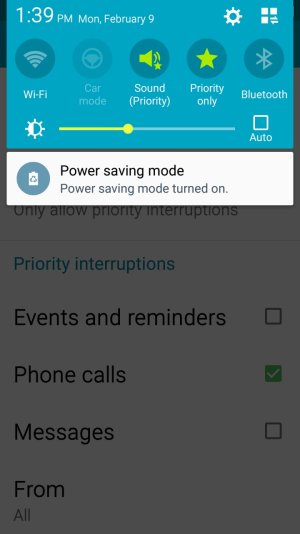

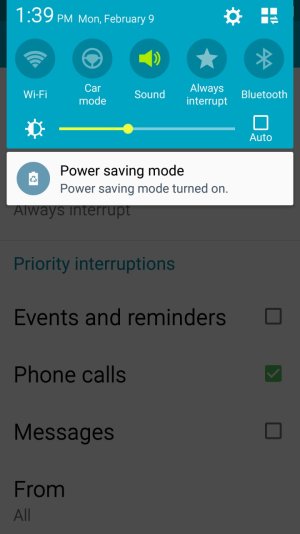

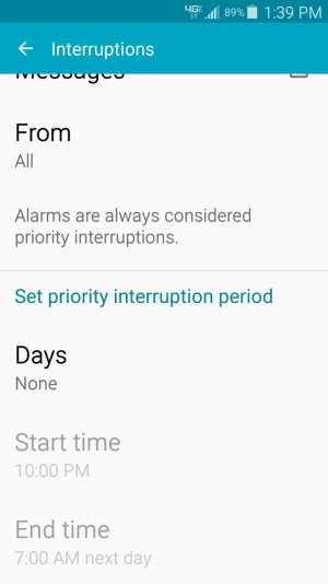

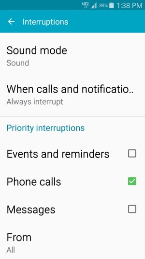

On my S5 with verizon.
Press the "always interrupt" icon which then says:"Priority only".
The sound icon changes to "Sound (Priority)
Pictures attached.

This is how i worked around the alarm on "silent" bug. Go to settings and set up what you want your phone to ring like when you have the audible ringer turned ON. now under Settings > Sound & Notifications, pick interruptions, UNCHECK Events/Reminders, Phone Calls and Messages. (I do not currently have any Priority Interruption Period setup.)
Now add the Priority Only shortcut to your top drop down notification bar, it is a little star icon. your phone should always be set to audible ring with the volume up (mine is about 3/4 up) and what determines if you hear any other notifications other than the alarm is that little star in the shortcut bar.
Think of it this way...
Priority Only = little star icon ON, is the equivalent of kitkat's silent but allows audible alarms. (LED does flash)
Always Interrupt = little star icon OFF is the equivalent of all audible rings, notifications, messages, alarms, etc.

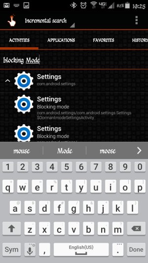

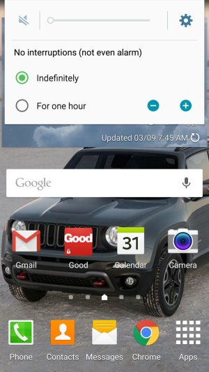

Ok here's how to get back Blocking Mode without root
Download: Check out "QuickShortcutMaker"
https://forums.androidcentral.com/e....sika524.android.quickshortcut&token=nEApiBc_
After installation you can choose this as a widget
Once you are in the app just search "Blocking Mode"
Baaaammm.... there you go.
Save the choice and you now have your old Blocking Mode back
