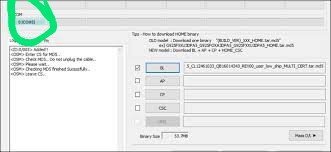

The process so far ... I have Odin version 3.14.1 installed on my PC along with the latest version of the Samsung USB drivers. I can boot my tablet into the download screen, then I connect it to the PC with a USB cable. I open Odin and it shows "added!", then I click the AP button and selected the CF-Auto_root file. Below is the info taken right from Odin....
<ID:0/004> Added!!
<OSM> Enter CS for MD5..
<OSM> Check MD5.. Do not unplug the cable..
<OSM> Please wait..
<OSM> Checking MD5 finished Sucessfully..
<OSM> Leave CS..
<ID:0/004> Odin engine v(ID:3.1401)..
<ID:0/004> File analysis..
<ID:0/004> Total Binary size: 28 M
<ID:0/004> SetupConnection..
<ID:0/004> Initialzation..
<ID:0/004> Get PIT for mapping..
<ID:0/004> Firmware update start..
<ID:0/004> NAND Write Start!!
<ID:0/004> SingleDownload.
<ID:0/004> recovery.img
<ID:0/004> FAIL!
<ID:0/004>
<ID:0/004> Complete(Write) operation failed.
<OSM> All threads completed. (succeed 0 / failed 1)

Does it say connected com on top in box of Odin?
Yes, that box is a light blue. Stays that way through the process. It says 0:[COM4]
