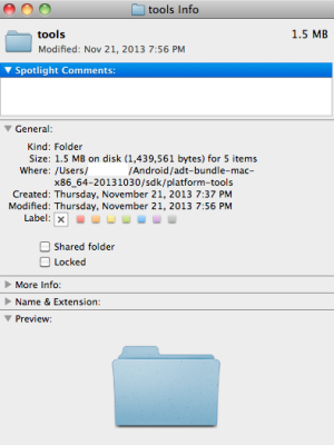

[NOTE]The location of the platform-tools folder is where you saved the SDK during installation. Refer to the save location, or if necessary, open a finder window and open the platform-tools folder. Right click (control+click) any folder or file inside platform-tools and select "Get Info". In the pop-up window look under General and refer to "Where". Highlight the entire destination and copy it (it should end in /platform-tools).
[/NOTE]
In Terminal, type the following:
Code:
cd<insert space><paste/type platform-tools location>

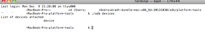

This means that we are now in the platform-tools directory and every command we run from now on will allow us to use ADB and push the necessary update files to the device. Let's check to see that our device is being recognized by typing the following into Terminal:
Code:
./adb devices
Terminal should return the device that is connected as a series of numbers and letters. If nothing happens, you get an error or a directory not found error then go back and check that you have "cd" into the right directory.
