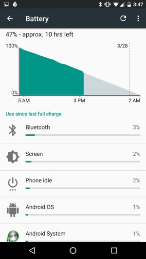

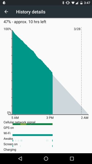

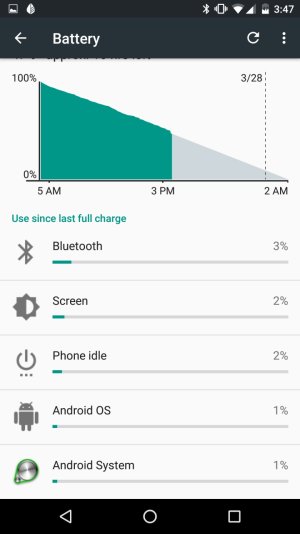

the phone was not really used but this occurred. The previous day i did use the Bluetooth in the car. I forgot to get times on the Bluetooth and screen but it was super low.

There have been some apps (like GasBuddy, Valentine1, etc) that one wouldn't imagine would use BT but they do and several of them do it badly.
I'd look into which apps have BT access and start there. The app, Aspotcat, might help identify which apps have that permission.
Gas buddy was draining my phone bad too... Uninstalled it a long time ago
Isn't the real issue that his battery discharged from 100% to 47% but the percentages in the battery stats don't come anywhere close to accounting for that drain?
