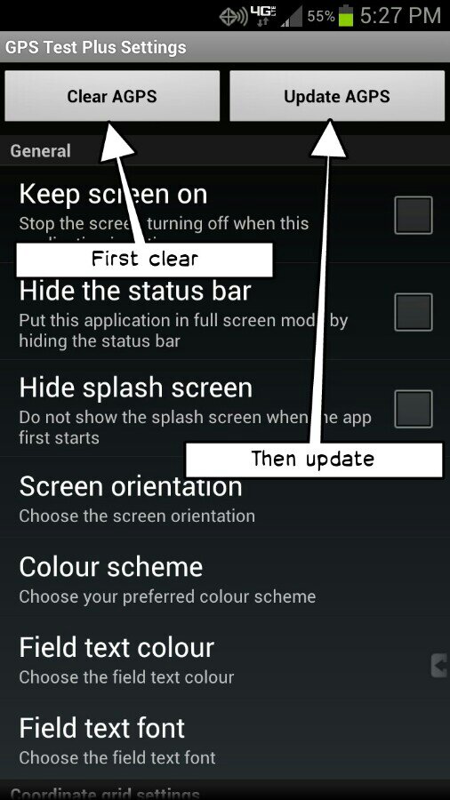

You can also take a look at GPS Test: https://forums.androidcentral.com/e...ails?id=com.chartcross.gpstest&token=t4vTOIMw to make sure you're getting a good lock independent of the Maps app.
I don't remember if the free version has this capability, but in the paid version you can reset the satellite database which may also help.
