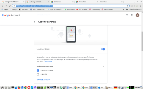

Similar thing solved my problem (honor7c).Log in your google account using desktop computer using browser than goto google dashboard and Activity controls. at the moment direct link is ( https://myaccount.google.com/activitycontrols ) than section "Location history" ,check if location history is ON.If it is ON look up for text "Devices on this account" that does not look as link at all, it looks completely as normal text and unimportant.
By clicking on that text that is actually link, it is being showed up a list of your devices, among them your device that is listed as inactive .Activate it and check if location history is working, i forced it using FIND MY DEVICE function.The device has showed up after a few minutes in location history .
The list of active devices does not match the list of devices shown in menu found in google play device manager settings.
Screenshot from 2019-10-26 19-34-49.png .
I posted image too.
And I hope I helped someone.

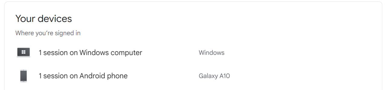

On the security page I see the device (Galaxy A10)
But on the Location History / Activity Control page between "On" and "Auto Delete" there should be "Devices on this account" pull down menu with the connected devices, but there isn't

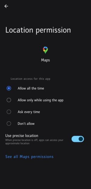

Have you given Maps location services permission? Is precise location enabled? Screenshot_20231115_004758_Permission controller.jpg

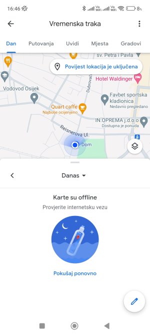

hi guys
please help.my situation :
i have several google accs.
My time line is worked untill i chsnged phone to huawei p30 pro.
on p30 pro i opened timeline but shows up "maps is offline,check int conn"
i deleted all timeline history on p30pro
yesterday i start use a antoher phone redmi 10 note pro,but i have same problem..
gps i working normaly,all premisions are set to use all time
data background is on
loc history on both acc is on.
here is sshot(on croatian).
this problem is shows up on many devices,but with same accaunt
