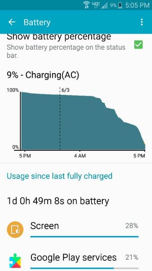

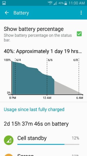

Check Google play services. My percent went up to 17% after the update. Tried clearing cache etc. What I believe worked was going into accounts, Google and turning off all sync. Restarted the phone and went back into the same settings and clicked gmail and calander for now.
