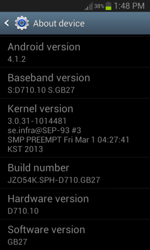

I have reported the exact same issue, as well as detailing it in a recent forum post to solicit some help. I'm surprised that my post has over 350 views, but ZERO replies. I'm wondering if some people were turned-off by the length of the post, but I was trying to be thorough with my description. Meanwhile, I ordered a new OEM Samsung Battery that should be showing up any day now. I'll report back if that solves/improves my issue.
Here's a link to my original forum post, which I'm guessing you might find familiar, based on the issue you've reported above. Good Luck!

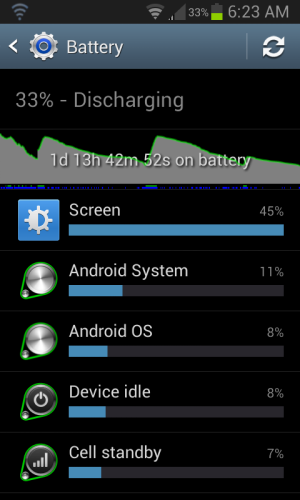

I've seen nothing but amazing battery life, much better then before upgrading! I've posted how to do this but I don't think anyone searches on AC anymore.
See attached...

I must say I too was very frustrated at my phones performance after installing the jelly bean update. Battery life sucked and phone was clitching, shutting down & restarting randomly, restarting when connecting to wifi to name a few. After researching various threads with people having the same issues I decided to do a factory reset of my phone as well as replace the battery. It is true that if you put your battery on a flat surface & spin it, if it spins freely it is time to replace it. New batteries are flat and should not rotate more than once depending on how hard you spin it. After the factory reset & battery replacement the phone is working like new and the battery is holding up as well. It is still early so time will tell but, I highly recommend doing this if you are having any issues after installing the jelly bean update.:D
