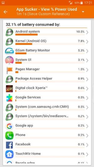

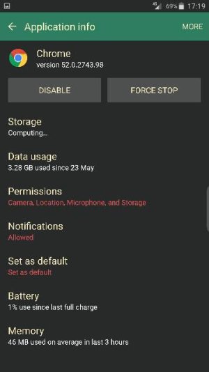

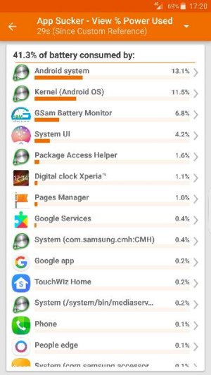

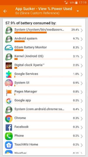

Just had this pop up again, see screenshots to show progress after clearing cache and force stopping chrome. Definitely chrome for me, shall try a reinstall and see if it stops totally.

Number 3, after clearing cache and force stopping chrome

Well all of the look fine except that one with it really high.
I've even using Chrome and it has been fine.
I took a screenshot and it went up again for me.
It's strange as it doesn't show up as chrome doing it, but if you force stop it the mediaserver loop stops. Uninstalling and reinstalling the app does nothing, it will eventually get stuck in a loop again.
