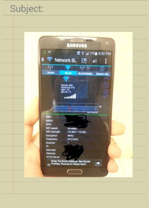

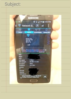

Guys, I made an important discovery! (I'm not sure if this is common knowledge or not, but I'm just throwing it out there for the uninformed.)
The Wi-Fi antenna is located near the top of the phone near the camera! I found this out when trying to watch a YouTube video lying down. Holding the top of the phone with my left hand, I noticed the video kept buffering. When I let go of that part of the phone (laying it down or just holding the bottom of the phone), the buffering resumes like normal without the video stopping.
Want more proof? Look at the two photos. One is with my hand on the bottom of the phone, and one is with my hand on the top. You can clearly see the Wi-Fi signal degradation when I'm holding the top of the phone. This is what contributes to slow Wi-Fi speeds.
Remember antennagate from 2010? Looks like a repeat of that here! But even my Note 2's Wi-Fi suffered from the exact same hand position, which goes to show that all smartphones suffer from antennagate, as Steve Jobs said.
In case you can't make out the text in the photos, I'll clarify some of them.
The one on the top (stronger signal):
Percent: 46%
WiFi speed: 26 Mbps (it also jumps up to 39 Mbps at times when the signal is around here)
WiFi strength: -75 dBm, 19 ASU
The one on the bottom (weaker signal):
Percent: 31%
WiFi speed: 6 Mbps
WiFi strength: -86 dBm, 13 ASU

Yep. The antenna's for the phone are located on the top and bottom (those white marks you see on the top and bottom are the indicators) so holding your hand around them will cause signal loss.
