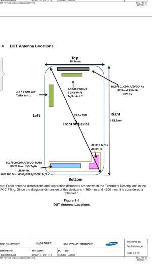

I learned them when on of our mods (dpham) posted the filings for the Note 4 as they went through their normal approval process (they show the internals on a diagram) -- So I figured it out then :).
It doesn't show the exact location in the public fcc filing, but does show approximate location. The easy way to check is to use an app like signal check to see signal strength, and put your hands over the top and bottom. You will see a signal drop. 6 just tried it and my signal went from 97 to 105.

Err...that's pretty bad news, isn't it? What does that mean for cases? Surely, cases cover the top of the phone.
Plastic cases shouldn't affect signal strength. A solid metal case would though. On the note 3, Samsung had the antenna on the back, behind plastic anyway.
