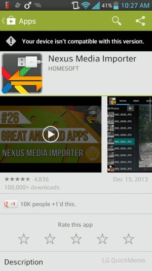

I found it finally by searching my apps where it still didn't turn up the first couple times I looked. I'm wondering if this is because this phone has onboard SD? But that doesn't make sense. And it's running 4.1.4 or such. Anyway over 4.1 which is required so I don't see the problem.
And now the screenshot it missing. It said "not compatible with your version" or such.

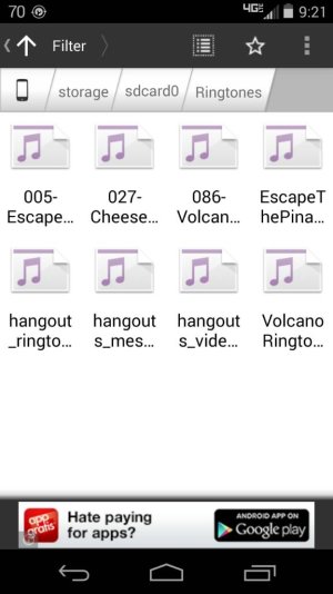

I did this last night. I just moved the files from "Downloads" to the already existing "Ringtones" folder and they work just fine. I did not have to create a new file.
Thanks for the help! I also moved song files into the folder and they worked as well.
